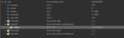

I’ve attached an image showing the callstack where the issue occurs. I hope this helps in diagnosing the problem.

I did some further analysis of the problem. Based on the "fault analyzer," we know that there is an attempt at an unaligned access. I have checked the address of &hdr->sipaddr, which is 0x30020036, and it is unaligned, right?
If I define a new IP address for testing purposes, which I then pass into the function, my program runs without hitting any hard fault or stopping. Could you please check the address of &hdr->sipaddr when you run the program? I will attach the latest version of the code.
