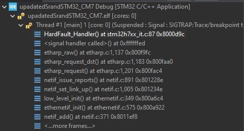

I’ve attached an image showing the callstack where the issue occurs. I hope this helps in diagnosing the problem.

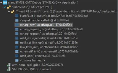

I tried building the project using Cube IDE with the same .ioc file. With this setup, the srand() function works, but I encounter a hard fault, as shown in the attached images.

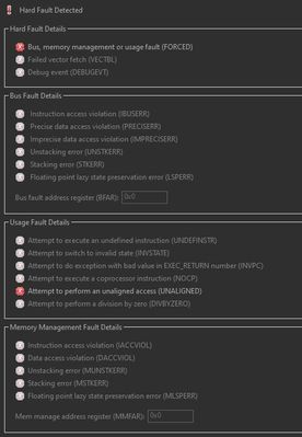

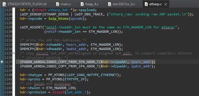

However, I’m still encountering the same fault. The Fault Analyzer suggests an "Attempt to perform an unaligned access".
