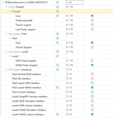

The software components I have selected in Azure RTOS are as shown in the image:

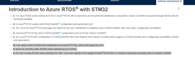

I find it strange to see ST pushing Azure over classic CoreMW without providing proper documentation and examples, as can be seen in this photo. Also I found it very difficult to configure Azure and other offerings through IOC file.
