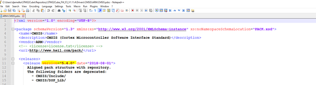

Hello @White_Fox and welcome to the Community :),
Which CMSIS version are you using?
-->The first difference is, that I do not have a folder "PrivateInclude"
Note that, the CMSIS version integrated in STM32CubeF3 1.11.5 is "5.4.0".
As mentioned in this FAQ
Thank you.
Kaouthar
2024-09-09 1:27 AM
Thank you KDJEM.1, this works definitly much better.
Indded, I'm using the latest firmware version 1.11.5 with CMSIS version 5.4.0.
