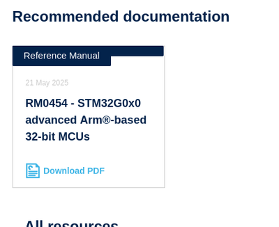

2026-02-16 6:10 AM
Where can we download the newest Reference Manual? When going to the site of the G0B0CE, it shows 2025 but downloading this RM gives the 2020 revision.
