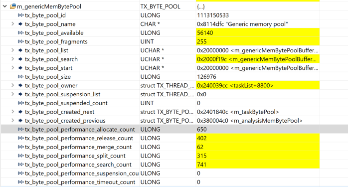

I am having issues with threadX tx_byte_allocate throwing a hard fault exception.
This only happens after some time of byte allocate and release. There are still plenty of available bytes according to the pool. But somehow in _tx_byte_pool_search it encounters some problem.
I am not posting the entire source code here as that will be huge. Anyway, I am using STM32H753. I created a byte pool using DTCRAM (128K).

This is the screenshot of the pool when the hard fault happens. byte pool available is still more than 50k

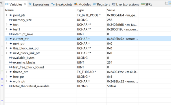

Below are the local variables during the fault. As you can see current pointer goes to 0x2492bc7e. That memory is not available for H753 and obviously will throw a hard fault error trying to access this memory.
Specifically on line below inside the do while(examine_blocks != ((UINT) 0)) loop
work_ptr = TX_UCHAR_POINTER_ADD(current_ptr, (sizeof(UCHAR *)));
free_ptr = TX_UCHAR_TO_ALIGN_TYPE_POINTER_CONVERT(work_ptr);
if ((*free_ptr) == TX_BYTE_BLOCK_FREE) //<-----------HARD FAULT
Now my question is why? Clearly, I have enough available bytes in the pool. You can also see below that the memory required is only 256 bytes. Even if the memory gets fragmented, I am pretty confident there is a block with 256 bytes free on it. Besides, ThreadX is supposed to merge those splits or fragments. Which is also stated in the pool above (tx_byte_pool_performance_merge_count)
