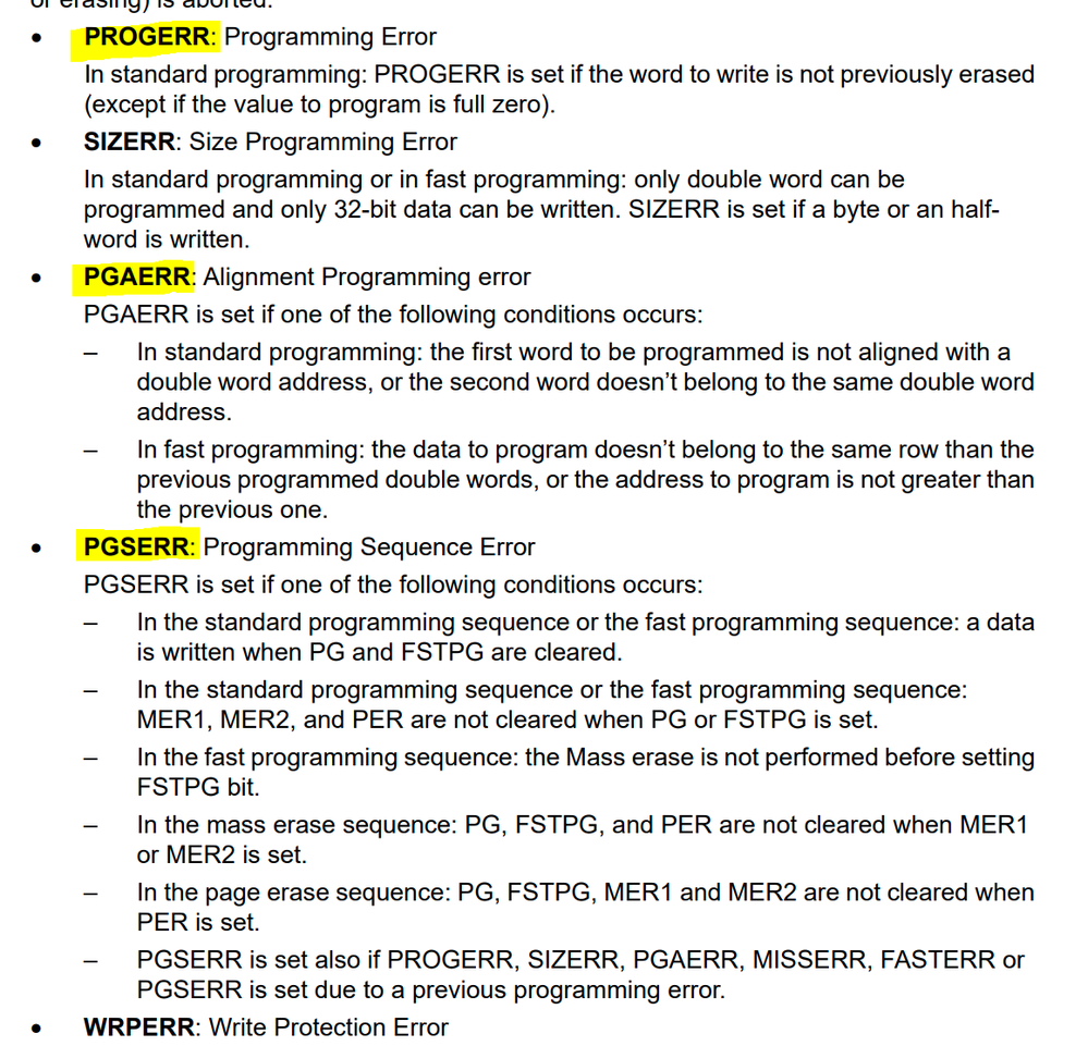

If it helps, the three flash memory errors I get from the MCU Flash-SR register after attempting to write are FLASH_FLAG_PROGERR, FLASH_FLAG_PGAERR, and FLASH_FLAG_PGSERR.

Boil the problem down to the bare minimum FLASH access calls that cause the error. No doubt you are performing some sort of invalid access. Writing twice to the same memory without erasing in between doesn't work. Writing less than a double word doesn't work. The RM gives exact conditions for these errors.
