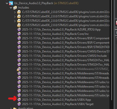

Having said this... @Mohamed_AYED your trick didn't work with me for some reason, but before the MX update, I was able to find it in the includes folder. This is after the MX update so of course I can't open it, but it would be under here:

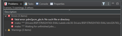

Something weird is going on though. But back to my error message:
I did not make any changes, so I'm not sure why there's that error - but I just noticed that in the other screenshot (the includes list), it shows a warning icon on it, and that's where the pdm2pcm_glo.h actually is.
Is there something corrupted that it can't load the hierarchy properly?

Ok I figured it out. The workspace was not set up correctly so I had to remove some things to force the right workspace to work.
And somehow the \Middlewares\ST\STM32_Audio folder was deleted, so I was able to copy that folder over from older project, so now it compiles nicely.
