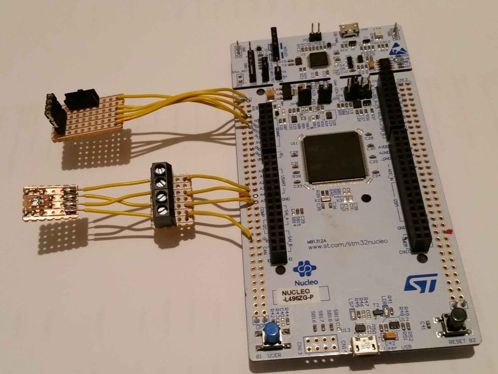

2020-06-30 6:20 PM
I use the UART bootloader for everything. For the Nucleo board below I added a little proto board that includes a switch to pull Boot0 to 3V when required. The 4 pin socket on the board brings out 3V, GND, UART TX and RX. I have a separate cable that has an RS232 converter chip on it that connects via the 4 pin header/socket. All my boards use the same cable/system.
(Note - the other protoboard in the picture is just a PDM microphone (flipped on its back)).
