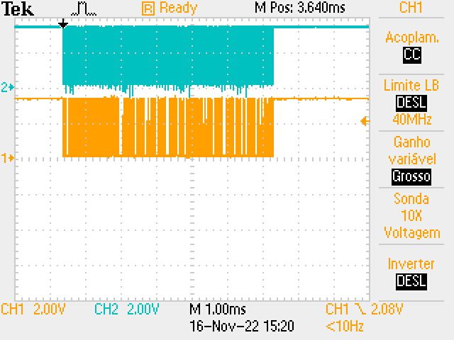

look osciloscope images below (I´m sorry .. I dont have a logic analizer)
OK (Blue is Clock .. it goes high after communication)
FAIL (Blue is Clock .. it goes low forever and I2C stops)
I only change the bytes to read using HAL_I2C_Mem_Read_DMA().
@ALORE.1​ Then you've likely found a bug in the new version (aka regression). You can report it here or on github.
