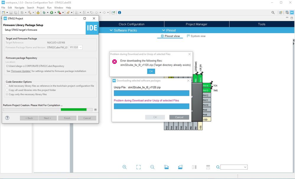

Thank you for your support. My question arises beacause if I try to create a new project based on L0 target in STM32CubeIDE 1.5, I get this error
How can I fix it?

Do you use a proxy? You can check the proxy settings in CubeIDE : Window > Preference > Network Connections.
If you use a proxy, you have to fill in HTTP and HTTPS, otherwise without proxy (with Direct and Native), you don't have to fill in the fields, just keep all fields empty.

This morning I managed to complete the download, probably the problem was with my corporate network...
