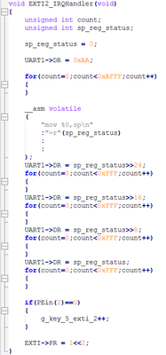

Nothing wrong that would explain this in the code you've shown.
2026-01-27 10:20 PM
FLASH APP? It's only in EXTI2_IRQHandler().
But I didn't trigger the interrupt.

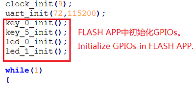

Maybe before jumping you first de-init / change the GPIO config, and that triggers the EXTI interrupt.
So try to disable EXTI first, the de-init the GPIOs.

BTW, so many (and long) for-loops in an ISR are usually not considered good design, unless you have some very specific reason for that.
Why not just set a flag and then "print" in the main loop?

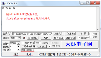

It still stuck.

If I set a flag,it is not timely enough in some condition.For example, more than 2 interrupts occur simultaneously.
"print" in the main loop is DMA or other methods?
2026-01-28 3:08 AM
With "print" I mean any kind of UART output.
You could trigger a DMA UART TX in the ISR, then you don't have to wait there.

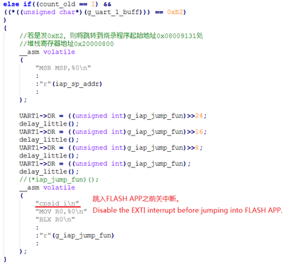

I'm not sure if I understand you correctly, right now it seems that the jump to the bootloader happens from within the ISR without any de-initialisations?
2026-01-28 3:52 AM
It sure looks like it did. The code in your interrupt is exactly what you show in your screenshot. I would recheck your assumptions here.
