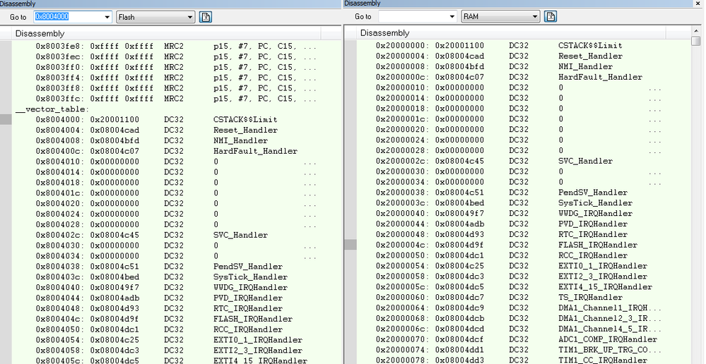

I thought it worked... now that I solved getting and writing the binary when I jump to 0x8004000 the app works except interrupts the first thing I do is remap table, I verified that the interrupts vector is in its place in RAM. the EXTI0_1_IRQHandler or SysTick_Handler never gets called even if I init them the same way I do in the main residing at 0x8000000.
#define APPLICATION_ADDRESS (uint32_t)0x08004000 void Remap_Table(void) { uint32_t i = 0; /*!< At this stage the microcontroller clock setting is already configured, this is done through SystemInit() function which is called from startup file (startup_stm32f0xx.s) before to branch to application main. To reconfigure the default setting of SystemInit() function, refer to system_stm32f0xx.c file */ /* Relocate by software the vector table to the internal SRAM at 0x20000000 ***/ /* Copy the vector table from the Flash (mapped at the base of the application load address 0x08003000) to the base address of the SRAM at 0x20000000. */ for(i = 0; i < 48; i++)2016-05-25 4:16 AM
