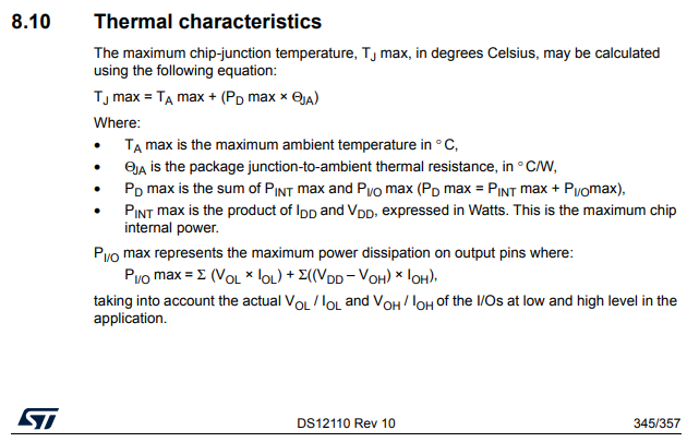

Take a look a this article - Basics of Thermal Resistance and Heat Dissipation:
Addendum:
https://www.st.com/resource/en/datasheet/stm32h743zi.pdf#page=345
See also AN5036, Guidelines for thermal management on STM32 applications:

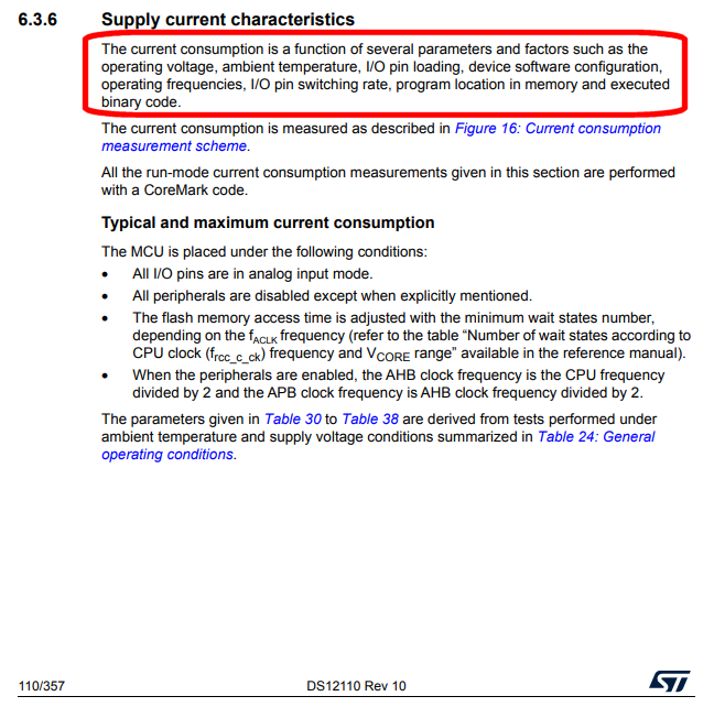

2024-09-17 5:50 AM
@SITARAM wrote:it is possible to increase temperature from the stable temperature ,it is possible to increase or it give stable temperature 46 0r 47 degree ?
Power Dissipation is closely related to current consumption:
So take a look at those Tables 30 - 38 (on the following pages of the datasheet) to see what's going to make the most significant difference to current consumption ...
https://www.st.com/resource/en/datasheet/stm32h743zi.pdf#page=110
