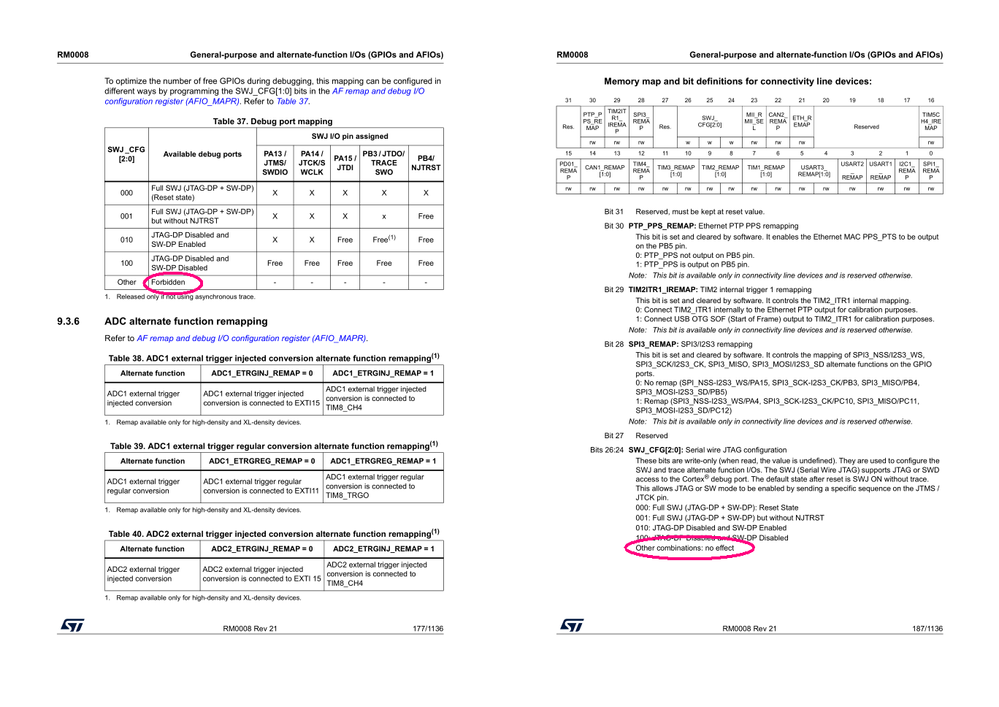

In particular, as brought up by @Richard Jones on January 25, 2018 at 12:26, the following two things are in contradiction to each other:
As the LL library already uses the "other combination" presumably with "no effect", it appears that the "forbidden" in the table is incorrect. Can this please be clarified once for all, too?

2- I highlighted internally your reported doc limitation in the internal ticket number 173730 to push for RM0008 update and enhance the documentation errata correction.
