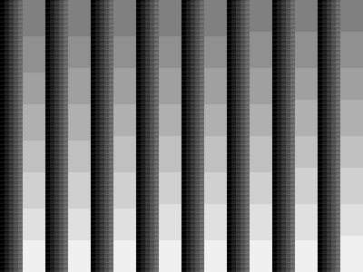

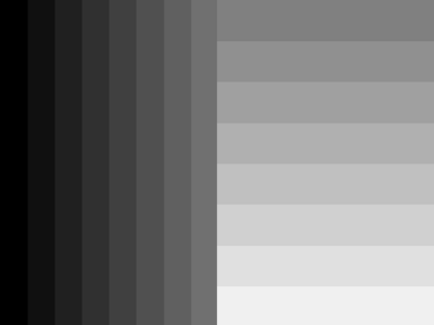

With a grayscale 8-bit image (on the left), the output encoded image (on the right) is totally different from the input. (the output screenshot is decoded by an external jpeg decoder).

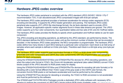

The JPEG standard used for the ST jpeg hardware codec is supposed to allow grayscale pixels as input format.
Hello @guigrogue
Yes, the JPEG standard used in ST JPEG hardware codec supports pixel input/output formats grayscale.
Please refer to the AN4996.
