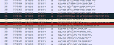

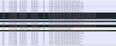

2025-09-29 6:44 AM - edited 2025-10-01 4:24 AM
@STackPointer64 @LCE Now,
I am not getting RBU DMA error but still,
Case 1: my STM32 not ack segments from peer and peer is requesting retransmission req continuously.
and lead to RST connection
within few min reconnecting continuously.
Case2 : Out of packets from peer. lead to retransmit req from peer (During retransmission req from peer my Eth IRQ is not triggering), This lead to pause in communication :(
