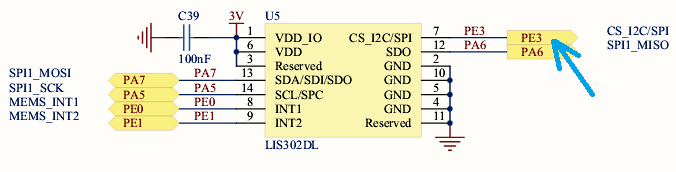

I'm not sure of any reference to PE3 being used by the System Loader.
PE3 is connected to the CS_I2C/SPI pin of U5 (LIS302DL) on the STM32F4-Discovery board. The table suggests this is PE2, the schematic says otherwise, as does the demo software. ST might want to fix that. ''When no communication is on-going, data on CS, SPC, SDI and SDO are driven by internal pull-up resistors''http://www.st.com/web/en/resource/technical/document/application_note/CD00167594.pdf
http://www.st.com/st-web-ui/static/active/en/resource/technical/document/datasheet/CD00135460.pdf
Table 5, Page 28 is WRONG wrt PE2 and PE3http://www.st.com/st-web-ui/static/active/en/resource/technical/document/user_manual/DM00039084.pdf
Already aware of this issue reported in this [DEAD LINK /public/STe2ecommunities/mcu/Lists/cortex_mx_stm32/Flat.aspx?RootFolder=/public/STe2ecommunities/mcu/Lists/cortex_mx_stm32/STM32F4%20SPI%2c%20Weird%20signals%20on%20the%20MOSIMISO%20lines&FolderCTID=0x01200200770978C69A1141439FE559EB459D7580009C4E14902C3CDE46A77F0FFD06506F5B¤tviews=245]thread, it will be fixed in coming user manual revision. -Mayla-To give better visibility on the answered topics, please click on Accept as Solution on the reply which solved your issue or answered your question.
