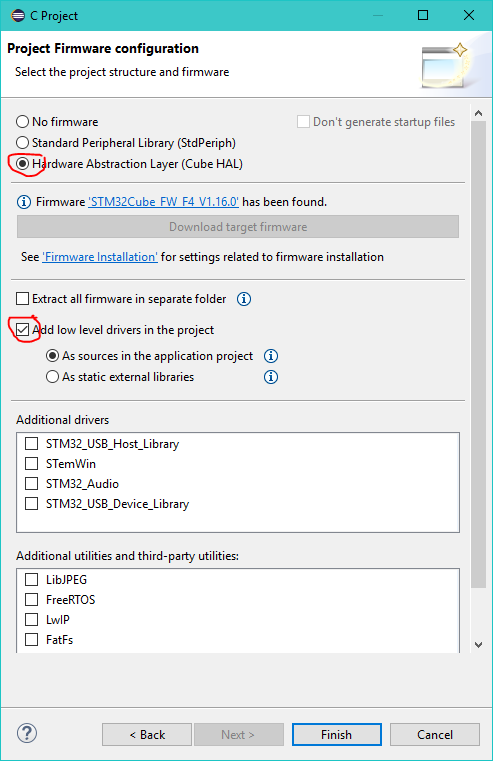

Hello I am trying to create new empty project only with HAL and CMSIS in SW4STM32. I've got STM32F401 and I want to use LL drivers. I create new C project and I set HAL drivers, HAL drivers have also LL driver. How can I use LL drivers? I get some mistakes. Below I put some pictures of this problem.

I have SW4STM32 v. 4.6.3
When create a project, for your MCU , at this screen you can choose between SPL and HAL
In case you choose HAL you have the option to add LL drivers in project.
I tried to make an empty C project for f401RE with HAL and LL and didn't faced the behaviour you described.
