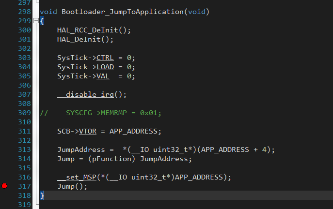

I am working on IAP in STM32F4. I received .bin file using uart and flash it in 0x08004000 address successfully and disable irq , set msp , set vector, deinit hal , reset the systick registers but the jump is not working , It just freeze there. Can anyone help me on this.

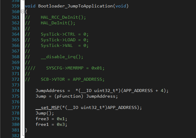

I now have a new problem. As an example IAP code using YMODEM is worked on my board. So, I thought of modify it to find the difference of my code and the example one. And I did but with little confusion. The code only works in optimization when I set level 0 it wont work. And I also need to add two variables next to jump statement. If I even comment one variable initialization It wont work properly. I don't know what to do?
2019-09-23 3:34 AM
