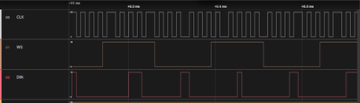

but the signal is as follows and I obtain crackling sound here:

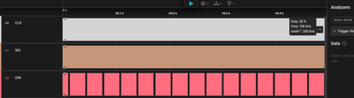

and just 4 bit of data is being sent per word select cycle as:
Can someone assist me?
