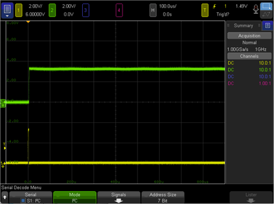

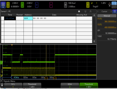

On the scope, I see:
line 1: start condition, addr sent, 4 bytes sent [addr=0x80, cmd=0xE0 0x00 0x00 0x00]
line 2: got interrupt and transmission_complete_flag set  (seems to get interrupt after first byte sent instead of end of frame)
line 3: Restart seen on scope, but no other data is sent.  I was expecting:
    Restart, addr, 4 bytes recv, stop

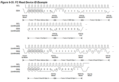

trying to accomplish this:
thanks

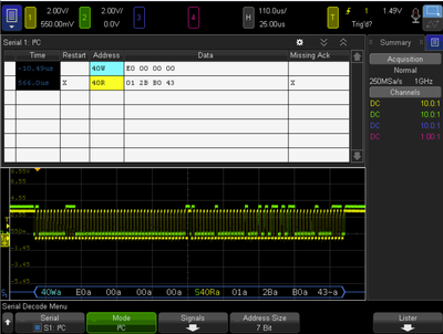

ok, I finally figured it out....  it's not that obvious and I couldn't find any documentation from ST...
Summary, to do a transaction like this:
use code:
	ret = HAL_I2C_Master_Seq_Transmit_IT(&hi2c1, XO2FPGA_ADDR, &cmd[0], 3, I2C_FIRST_AND_NEXT_FRAME);
	while (transmission_complete_flag == 0) {} ;  transmission_complete_flag = 0;
	ret = HAL_I2C_Master_Seq_Transmit_IT(&hi2c1, XO2FPGA_ADDR, &cmd[3], 1, I2C_LAST_FRAME_NO_STOP);
	ret = HAL_I2C_Master_Seq_Receive_IT(&hi2c1, XO2FPGA_ADDR, data, 4, I2C_OTHER_AND_LAST_FRAME);
	while (reception_complete_flag == 0) {}; reception_complete_flag = 0;
