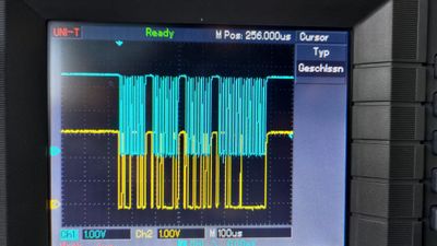

I seem to have a similar problem, besides, that DMA is disabled.
I have an STM32H503RB (NUCLEO-H503RB) trying to read out some I2C slave devices. It actually works only for one of the devices. This tells me, that the I2C bus is somehow working correctly.
But for the remaining three IC (Temperature, GPIO & ADC), there is no way for me to even send the register address.

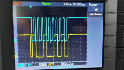

Right after the Device address, the communication ends. See the attached file. This is the communication to an MCP9801T temperature sensor (device address [W] = 0x92).
I actually don't understand the reason, why this happens.
f=100kHz

Here is the picture of addressing all 4 ICs one after each other:

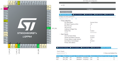

}This is my I2C configuration:

What I tried additionally:
- changing to 400kHz: no improvement
- changing to 50kHz: no improvement
- adding an I2C sensor that I successfully used in the past with another microcontroller which has Pull-ups of 1kOhm soldered next to it. This sensor cannot be addressed as well. Same picture on the oscilloscope.
- with these 1kOhm-Pull-ups I tried to access the 4 other Slaves: picture unchanged: GPIO, ADC & Temp failed, LED-DRV still possible to send the address byte.
