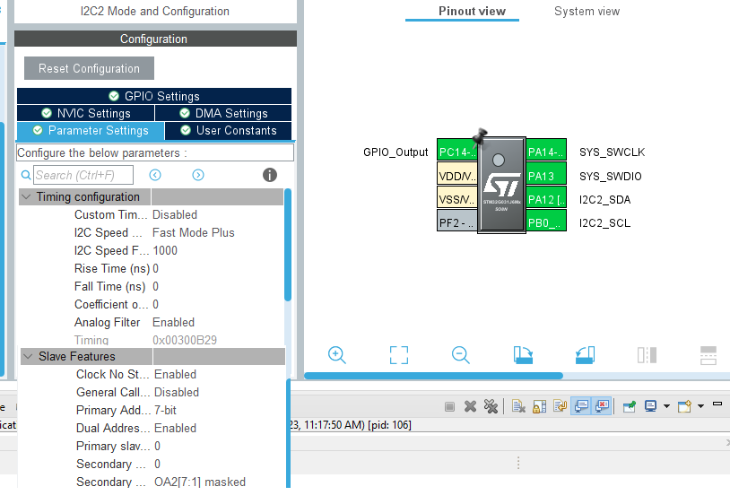

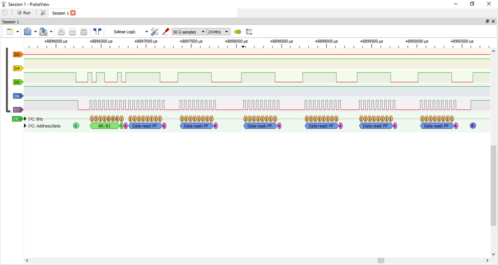

Hello everyone! I have been complaining about this for 1 week. I can't make "HAL_I2C_Slave_Seq_Transmit_IT" send data to the master, but Slave to master ACK works fine, does anyone have any advice to give me that can guide me a little? I am using the STM32F030. in another way i need the slave to respond to many ADDRESS for this i configure the mask to pass any address possible. Clock STRETCH or not dont affect this trouble.
The interruptions in "NVIC settings" are activated (i2C global interrupt), the frequency is the maximum possible (64Mhz) and the master speed is 20Khz, I have also tried with 100,400,1000 Khz and nothing worked, the Slave ACK perfectly in any frequency. in another way if i use "HAL_I2C_Slave_Seq_Receive_IT" slave receives data perfectly. in another way when i try to transmit data to master, im getting in
"HAL_I2C_GetError(hi2c);"
the error code 0x0A.... what this mean?

Hi everyone and thanks for taking your time in help me. I decide to search and make in LOW-Level implementation in Blocking mode, this Works perfect for me.
void HAL_I2C_AddrCallback(I2C_HandleTypeDef *hi2c, uint8_t TransferDirection, uint16_t AddrMatchCode){
I2C2->TXDR = 1;
while(!READ_BIT(I2C2->ISR, TXIS));
I2C2->TXDR = 2;
I2C2->TXDR = 3;
PD.: Any HAL function return the data to the master included function in Blocked / non bloqued / DMA mode
