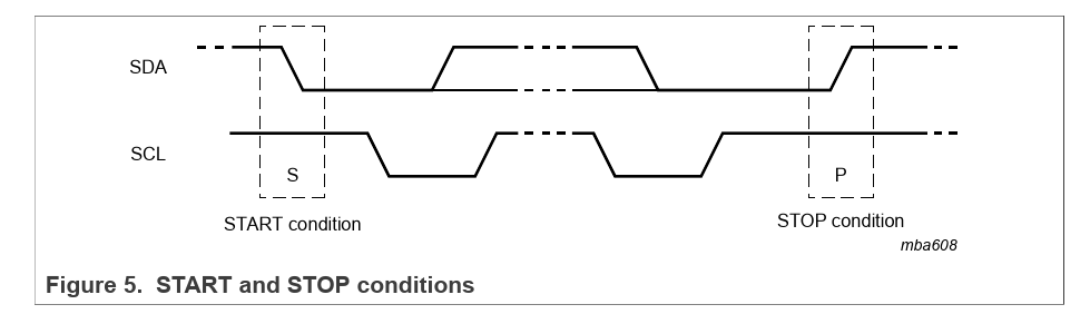

> As I said, on SCL line I see falling edge and no pulses. On SDA nothing
thats totally wrong. or exchange scl-sda ...
first is : falling edge sda = start . then...pulse scl ...

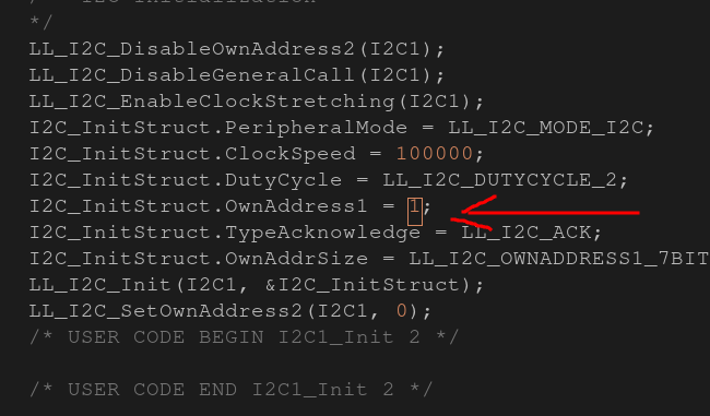

2023-02-06 9:36 AM
Guys, you are not gonna believe! I've just set i2c address of my device and now it just works. It seems like stm's i2c controller dont bother it runs as master. It craves address of slave anyway lol. Is this bug in stm32 microcontrollers? It said nowhere about it
