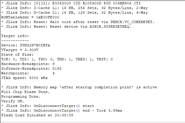

When I try to use this flm file to download code on keil, I get errors like below:

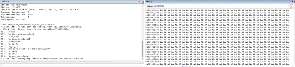

2024-12-20 4:41 AM
thanks for your help , after I check this flm file, I found all data get 0XAA , I do not know why cause this ?

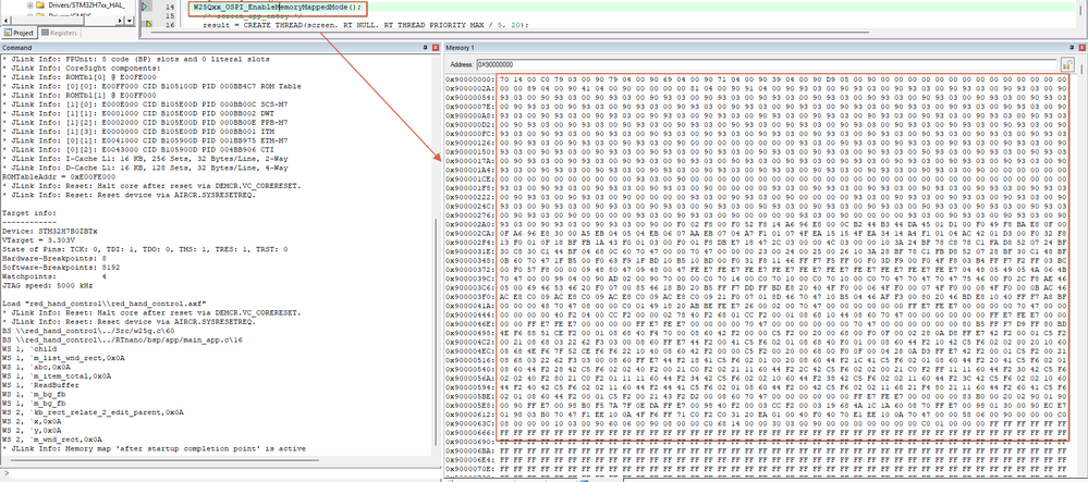

2024-12-20 5:06 AM
After I enable flash map , then I check the external flash data is right ,very thanks for your help .
2024-12-20 7:54 AM
Yes, as a general rule I don't use Memory Mapping in the loaders, and either have a .INI for the debugger, or bring up external memory in SystemInit() so run-to-main has it visible prior to hitting the break-point in main()
