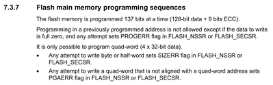

RM0456 Rev 3:
7.3.7 Flash main memory programming sequences
The Flash memory is programmed 137 bits at a time (128-bit data + 9 bits ECC).
Programming in a previously programmed address is not allowed except if the data to write
is full zero, and any attempt sets the PROGERR flag ...
hth

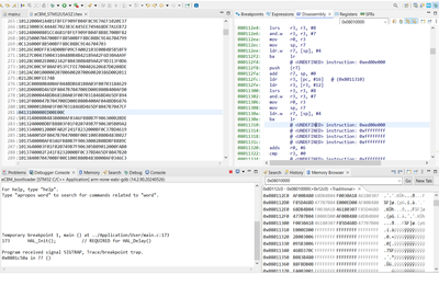

2026-01-07 9:53 AM
TDK,
I attached a screenshot from STMCube.
It shows an Intel Hex file generated by the IDE. I used it to update my Application program. The result was a corrupted program. We typically used Intel Hex files with our basic BootLoader to update our code in the field. This won't work any more. What is the STM solution for updating code?
I don't mind the 16 byte block write, but preventing block re-writes with the ECC bits was a realy, realy, realy bad idea. What were you guys thinking?
Jim Eno
