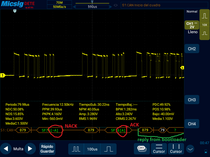

2021-02-22 9:10 AM
And here i am with the same bug 2 years later, facing the same choices.For some reason the bootloader expects that first 0x79 to be NACKED maybe a cruel unfortunate way of checking if they are the only ones in the bus.
