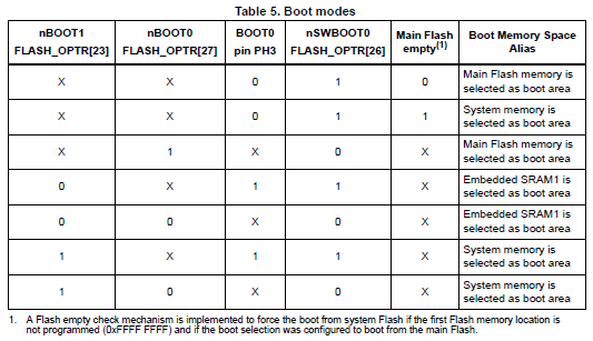

The hardware method
Add some external components to the pin so it can hold its state for a couple of microseconds.
The software method
Boot pins can be overridden by the nSWBOOT0, nBOOT0, nBOOT1 user option bits
but then you'll have to change them back through the DFU or serial bootloader interface to be able to boot from main flash again.
2020-01-03 4:37 AM
Thank you for this very fast and accurate response. Amazing!
(I will implement the hardware method on the next board revision.)
