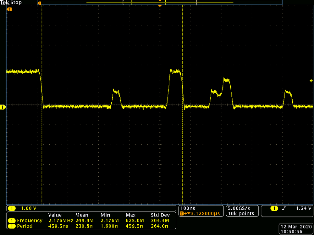

This is a screen capture of a scope trace of TXD1. This signal looks strange. We disconnected TXD1 from the phy so we could see only what was coming out of the MCU. Any ideas why this is happening?
2020-03-13 11:43 AM
Check the solder quality. Check the GPIO configuration, probably try different speeds for pins.

We cleaned up the signal, and we got loopback to work on a 1.8V nucleo.
The key issue was here:
GPIO_InitStruct.Pin = ETH_TX_EN_Pin|ETH_TXD1_Pin|ETH_TXD0_Pin;
GPIO_InitStruct.Speed = GPIO_SPEED_FREQ_VERY_HIGH; <------------------- This line was to low
GPIO_InitStruct.Alternate = GPIO_AF11_ETH;
HAL_GPIO_Init(GPIOG, &GPIO_InitStruct);
Once we set the gpio speed to very high, loopback started working at 1.8V on the nucleo
