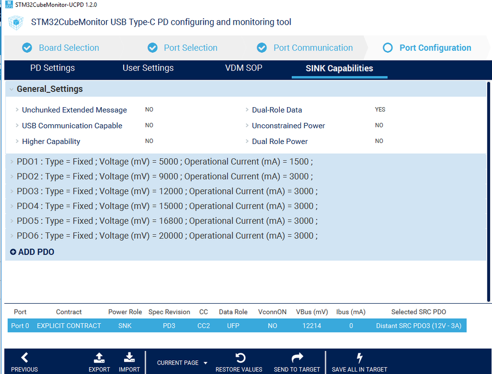

I am working on the STM32G0B1RE processor as a USB-PD SINK.
I would like to ask what is the easiest and fastest method (preferably using CubeMX) to request higher voltages from the USB-PD port (for example 9V or 12V)? Can anyone share the simplest code to request a different voltage from USB-PD than 5V?
Thank you and best regards.

2022-01-11 3:20 AM
Hello @Jakub Pepliński
Please see this wiki for your request: https://wiki.st.com/stm32mcu/wiki/STM32StepByStep:STM32_Advance_USB-Power_Delivery_Sink
It explains how to create a simple PD sink, using CubeMX.
To select 9V or 12V, you will need to follow the complete wiki, including the advanced section.
Best regards

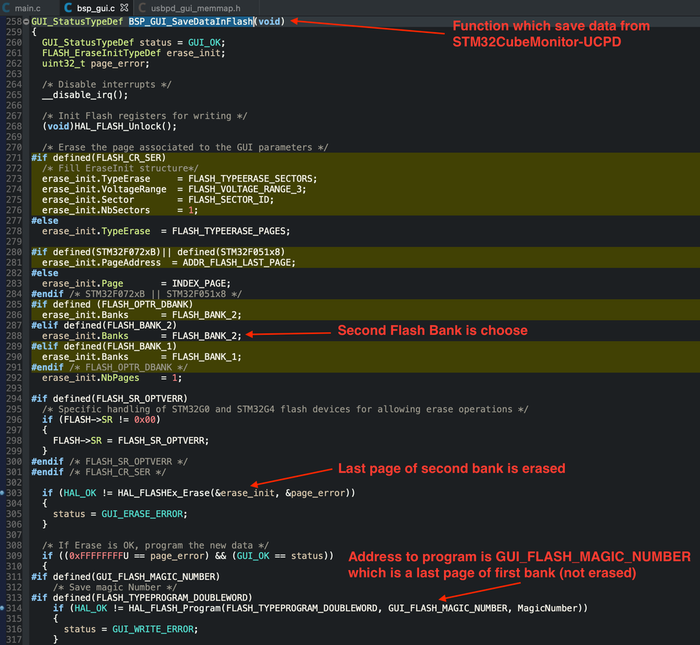

2022-01-20 3:03 AM
Hello @HFISTM
Thank You for your help. I took Your advice and used information from this wiki.
Almost everything is working with only one little issue :) I think that this is a BUG in HAL Library.
As I said - I am using NUCLEO-G0B1RE (not NUCLEO-G071RB like in this tutorial on wiki). The difference is that STM32G0B1RE has dual bank flash memory.
Now - when You try to use STM32CubeMonitor-UCPD and save some information in Flash using "Save all in target" there is a problem and this is not working
In file bsp_gui.c, in function 'BSP_GUI_SaveDataInFlash(void)' - https://github.com/STMicroelectronics/STM32CubeG0/blob/03cb8e9ec0cbefad623caebe47359df0bab1d05e/Utilities/GUI_INTERFACE/bsp_gui.c#L258
First there is set :
erase_init.Banks = FLASH_BANK_2;Then Flash page is erased:
if (HAL_OK != HAL_FLASHEx_Erase(&erase_init, &page_error))
status = GUI_ERASE_ERROR;
}The page which is erased is last page of second bank.
And then Flash memory should be write:
if (HAL_OK != HAL_FLASH_Program(FLASH_TYPEPROGRAM_DOUBLEWORD, GUI_FLASH_MAGIC_NUMBER, MagicNumber))
status = GUI_WRITE_ERROR;
}but address to be write is GUI_FLASH_MAGIC_NUMBER which is last page of first bank (and this page is not erased).
Look at the picture below. Everything should be clear then:

2022-01-25 1:32 AM
Hello @Jakub Pepliński and thank you for your analysis.
You are indeed right, this issue will be updated on our side.
Meanwhile, to fix it, you can try to add this line:
#if defined (FLASH_OPTR_DBANK) || defined(FLASH_DBANK_SUPPORT)instead of:
#if defined (FLASH_OPTR_DBANK)in file usbpd_gui_memmap.h, line 51.
This is due to a different flash flag name between G0 series, and it should be updated in the template accordingly.
Can you confirms that it works for you with this fix ?
Thank you,
Regards
2022-01-25 1:39 AM
Hi @HFISTM ,
Yes, this solution work perfectly fine.
I also figured it out a few days ago and tested it and it works great.
