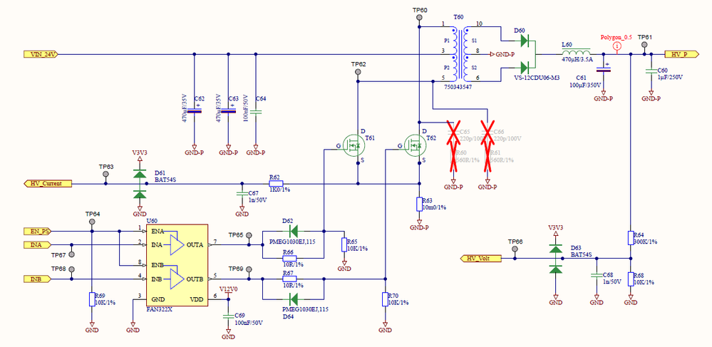

I means that i will use the HRTIM for a Push pull power supply topology. (not the GPIO in push-pull mode).
see also RM0440 page 828
like in this schematic:
In the CubeMx is there a option for: "Push Pull".

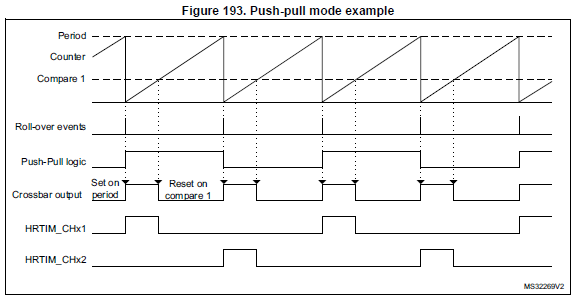

This are the output signals i need:

HRTIM_OUTPUTLEVEL_ACTIVE);I can see the signal on channel TE1, but the signal on channel TE2 has always a duty cycle of 50%
The set and reset source are configured as follow:
pOutputCfg.SetSource = HRTIM_OUTPUTRESET_TIMCMP1;
pOutputCfg.ResetSource = HRTIM_OUTPUTRESET_TIMPER;And i use only the compare 1 register and the DEADTIME is active between the 2 outputs
