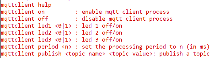

My goal is to test MQTT on the device using X-Cube-Cellular v5.2.1 which has the MQTT client application. I have followed the readme to use IAR workbench IDE to include the relevant MQTT folders. I have also set the variables to use MQTT client.
I see these commands printed here. But the publish command doesn't work when I try to publish to the Hive MQ public MQTT broker. It seems to get stuck.

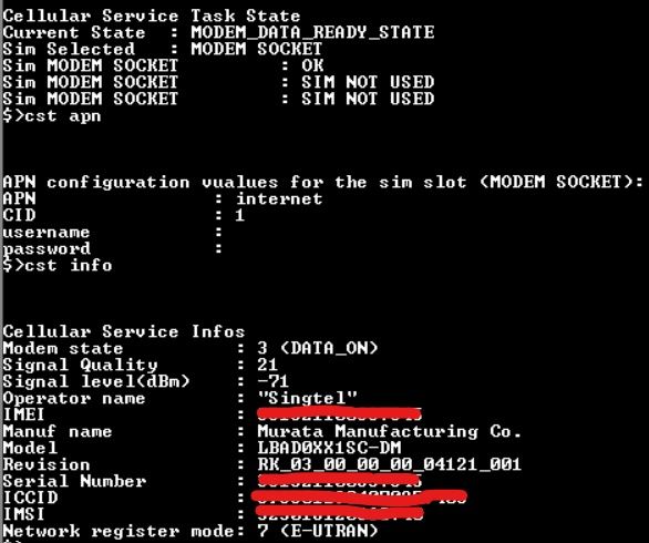

I don't think this is a network related issue, since I used the cst command to check that my SIM has been configured already and I can received a signal.

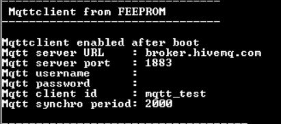

My MQTT client configuration is seen here:
Any ideas? Would appreciate some help from ST or the community. :)
