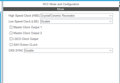

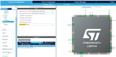

The only changes I made was to change the HSE to Crystal/Ceramic Resonator.
NMI can be a symptom of clock failure. And CRS is disabled. Check the HSE stability.

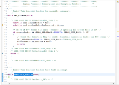

I added the following code to the NMI_Handler
volatile bool ignoreEccErr = true;
volatile bool eccDoubleBitErrOccurred = false;
/* Check if ECC double bit error occurred if ignoring ECC errors flag is set */
if (ignoreEccErr && (READ_BIT(FLASH->ECCDETR, FLASH_ECCR_ECCD) != 0U))
/* Reset the detection flag to enable detecting subsequent double bit ECC errors */
SET_BIT(FLASH->ECCDETR, FLASH_ECCR_ECCD);//FLASH_ECCR_ECCD
eccDoubleBitErrOccurred = true;
return;
Now the code jumps over the NMI_Handler and stops at the HardFault_Handler.

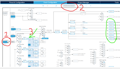

As I have a crystal connected on my custom board I have to change the HSE to a crystal
Then I need to Setup the Crystal speed to match the Fitted Crystal. I used the "Resolve Clock issues" for STM32CubeIDE to set the output clock speeds to 250MHz(Circled in green)
Last night when I followed the same process I changed the PLL1 setting downwards to give me an output of 231MHz.
The board has been running through the night Without crashing. Code is the same. Can someone please explain to my why this works. Or if I run at the Max speed of 250MHz, what else should be adjusted to mitigate the "NMI_Handler" Error
