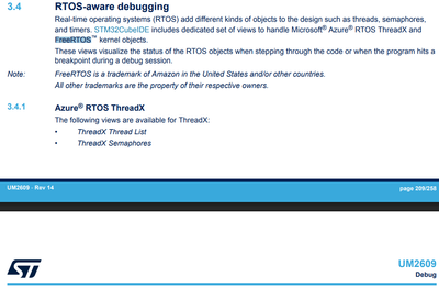

@kavyamm wrote:debug the code of freertos
How to set up FreeRTOS debugging using STM32CubeIDE
https://www.youtube.com/watch?v=KTsrP28Gh6E
https://www.st.com/resource/en/user_manual/dm00629856.pdf#page=209
