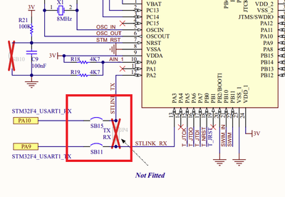

Are you sure SB11 and SB15 are soldered and JP4 not fitted?

Did you check the schematics (as I described previously)?

Attached a project that prints "Hollo World" using printf over USART1.
Need first to check which COM was allocated by windows to your STLINK VCP in Device manager:
Then in the HyperTerminal to configure these parameters:
Baudrate: 115200
Datasize: 7
Parity: None
Handshake: Off
Hope it helps.
