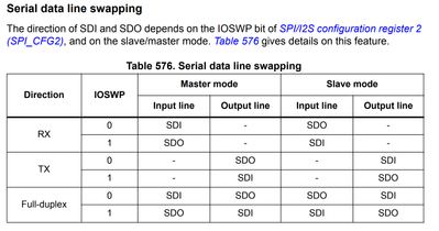

>I had similar problem and after long time searching i found: it was on the wrong pin tx <--> rx swapped.
The rx was on the tx pin...thats what i tried to explain. (Dont ask me why...)
Look in rm of your chip, registers of the I2S : is there a swap bit ? (swap rx - tx ) .

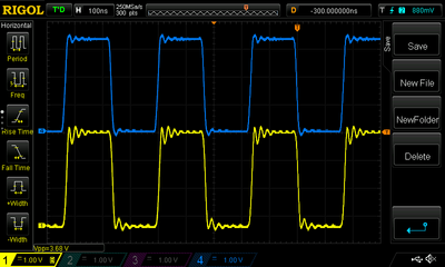

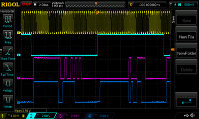

EDIT2: Here are two screenshots from oscilloscope:
1. Shows clock signal on master vs on slave (probes were connected on two ends of cable that connets I2S2 and I2S3 clocks)
ch1 (yellow) - slave clock
ch4 (blue) - master clock
2. Shows data from microphones
ch1 (yellow) clock
ch2 (turqoise) ws
ch3 (pink) i2s3 (slave) data
ch4 (blue) i2s2 (master) data
If I can provide you with more information, let me know.

2026-01-18 5:53 AM - edited 2026-03-07 12:02 PM
from H743 :
2026-01-18 9:04 AM
It worked, thank you very much!
I wonder why did Cube configure it differently?
