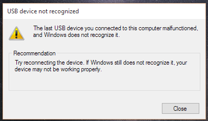

I have STM32F103C8T6 development board (like this: https://www.rogerclark.net/wp-content/uploads/2014/11/STM32Mini.jpg) which can be programmed by USB interface. I programmed it several time before, but now I can't do this. When I connect it to the PC, I get a warning messege (pinned) and can't load firmware to the STM.

Thanks for reply. It's a new board. All that I was do - it load blink code (then it worked). I did nothing with bootloader. I was try to connected board to the another PC, by another usb cable, but it's still not working:slightly_frowning_face:
