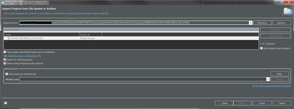

Hi, I am trying to do some audio project based on STM32F7/F4 series. I have got STM32F769I-DISCO board. I have downloaded x-cube-audio v.1.1.1 and x-cube-usb-audio v.1.0.0.
I have unpacked both packages and I am trying to build and run some example (starting from Import->Existing project into workspace). Every project that I am trying to build ends up with "Nothing to build for project..." in CubeIDE. What is the best way to start with such examples?

Maybe you have been a bit confused while trying to import.
In older projects like this one you can find some project files for different target GUI. In this case there is:
The latter one can directly be imported into STM32CubeIDE using
Good luck!

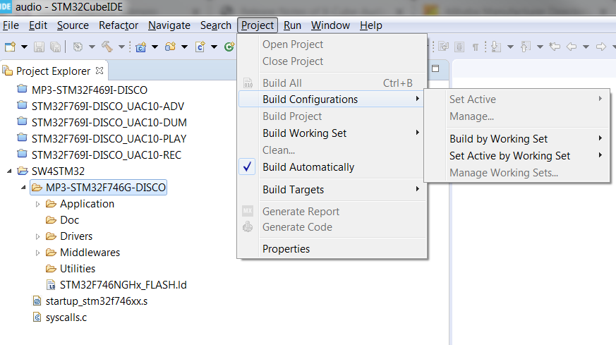

2021-01-08 5:49 AM
Thanks for this nice explanation. I have tried what You wrote. Problem was probably also with very long path. After shortening I was able to find this Eclipse project.
Despite this fact, I am still struggling to build, now I have no configuration to choose, do I need to set it manually?
2021-01-08 1:43 PM
@Antek Try to remove imported materiel and redo promoting full path (....../SW4STM32/MP3-STM32F746G-DISCO) ... sounds to me you've not initiated import from proper level. Obviously you should have build configuration set for you if import done properly.

2021-01-11 1:56 AM
I am not sure what I was doing wrong but something is starting to work.
Still I warn everyone that paths are really long with these libraries.
I attach screen with correct import.
