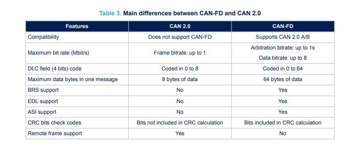

The FDCAN and CAN protocols are totally different. You can refer to the AN5348 FDCAN peripheral on STM32 devices:
Note that the ST-link V3 supports CAN bootloader and does not support FDCAN.
So, you should implement a host software that supports FDCAN.
