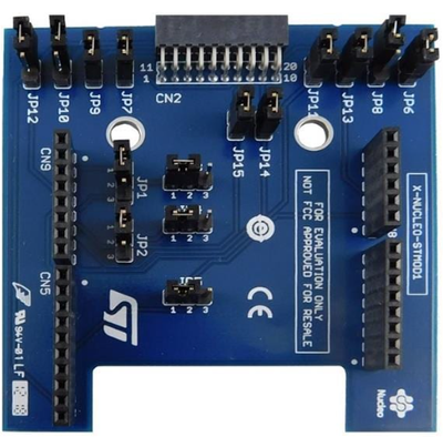

Hi @srikanthpalvai From the X-CUBE-CELLULAR description, you need STMod+ adapter to connect the cellular device to the Nucleo.
The software supports STM32U5 family, and, per the description, LCD or external memories are not required So it should be possible to run it on this Nucleo.

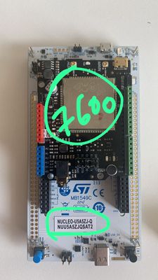

I believe I can utilize it directly without the need for the STMod+ adapter, as the SIM7600 is designed as a HAT for the Nucleo board.
However, I'm interested in understanding if the X-CUBE-CELLULAR package includes a custom modem interface section or any specific provisions that would allow me to integrate my SIM7600 module without having to modify the entire cellular code base. Essentially, I'm looking for a way to seamlessly incorporate my modem into the existing framework without significant modifications.
