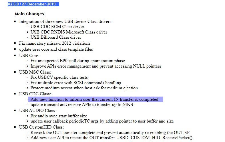

Yes, the F3 firmware pack uses an old version of the USB device library (2.5.3) from April 2019.
This callback was added in 2.6.0 December 2019.
You can try to simply replace the library (or even just the CDC library files your project uses) with a newer version (from the G4 firmware pack for example) and work through the compiler errors, if any. Maybe you'll get lucky.
The invocation of the callback in the new version of the lib comes from a simple change to
USBD_CDC_DataIn:
static uint8_t USBD_CDC_DataIn(USBD_HandleTypeDef *pdev, uint8_t epnum)
else
hcdc->TxState = 0U;
// this was added in 2.6.0
if (((USBD_CDC_ItfTypeDef *)pdev->pUserData)->TransmitCplt != NULL)
((USBD_CDC_ItfTypeDef *)pdev->pUserData)->TransmitCplt(hcdc->TxBuffer, &hcdc->TxLength, epnum);
return (uint8_t)USBD_OK;
So, in the worst case, you can diff the two versions and pick out only the changes relevant to CDC (added struct members, updated code generation templates, etc), and apply them. It's not fun, but it's doable.
