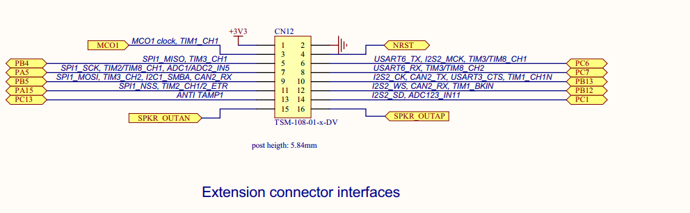

I'm trying to get work speaker output on my Discovery kit (STM32F469I-DISCO) but not succeed yet. I have connected
https://www.gme.cz/reproduktor-ls45n-3-r8-45mm-8ohm-1w
on pins 15 and 16 of extension connector CN12 and have used example 'Audio_playback_and_record' from 'STM32Cube_FW_F4_V1.16.0' repository, but cannot hear anything.

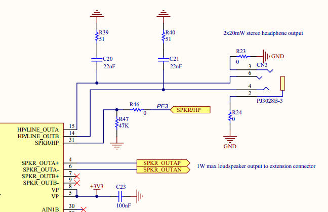

To get sound on the speaker, you should connect his loudspeaker (Left, Right and GND) to SPKR_OUTAN (pin 15 on CN12), SPKR_OUTAP(pin16 on CN12) and GND pin.0690X00000608fWQAQ.png0690X00000608YVQAY.png
SPKR/HP mapped on PE3 is an input Speaker/Headphone switch. It powers down the left and/or right channel of the speaker and/or headphone outputs as described in CS43L22 codec datasheet.
To power down the channel of the speaker/headphone, you have to configure this pin as input and connect it either to GND or VDD.
However, this pin is not exposed on the STM32F469I-Discovery, then it cannot be controlled. It?s a choice made to not power down speaker/headphone; so no BSP API is supporting this switch.

thank you for your advice. I was probably (and still I am) confused with a description in the datasheet of discovery kit:
Each of the two terminals of the external loudspeaker should be connected to pins 15 and 16 of CN2 respectively. Insure the terminals of the loudspeaker are not connected to the ground.
I supposed that I should connect my speaker to pins 15 and 16 of connector CN12. Now I have tested to connect my speaker to pin 16 and GND and it's working. From description is not much clear to me if I have to connect both pins 15 and 16 to any speaker. And note about 'not connecting terminals of the loudspeaker to the ground' means to not connect pin 15 directly to GND but through the speaker with impedance 8ohm?
Thank you for your clarification.
Tomas
Posted on October 29, 2017 at 22:55
The output has a significant DC component, i.e. you'd need to decouple it with a large capacitor if connected to ground.
The two outputs have the same DC level and they work in opposite phase, that's why you are supposed to connect the speaker between them.
