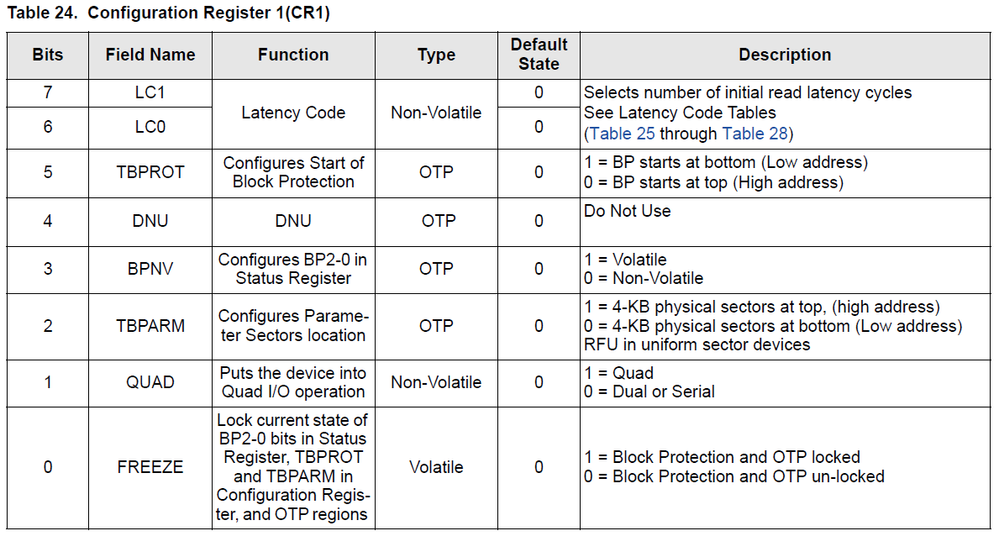

I want to change the state of the Configuration register bit 1 from the default of zero to a one.

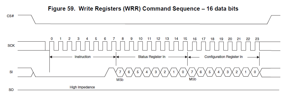

I want to use the HAL_QSPI API to perform this write but I’m confused on how to add two byte command sequence.
Instruction WWR = 0x01

How do structure this command to add my two byte command sequence?

The following from QSPI spec on how the data write should be formatted:
2019-10-14 1:20 PM
uint8_t data[2];
/* Read two bytes --------------------------- */
sCommand.InstructionMode = QSPI_INSTRUCTION_1_LINE;
sCommand.Instruction = CMD;
sCommand.AddressMode = QSPI_ADDRESS_NONE;
sCommand.AlternateByteMode = QSPI_ALTERNATE_BYTES_NONE;
sCommand.DataMode = QSPI_DATA_1_LINE;
sCommand.DummyCycles = 0;
sCommand.DdrMode = QSPI_DDR_MODE_DISABLE;
sCommand.DdrHoldHalfCycle = QSPI_DDR_HHC_ANALOG_DELAY;
sCommand.SIOOMode = QSPI_SIOO_INST_EVERY_CMD;
sCommand.NbData = sizeof(data);
if (HAL_QSPI_Command(&QSPIHandle, &sCommand, HAL_QPSI_TIMEOUT_DEFAULT_VALUE) != HAL_OK)
return 0;
if (HAL_QSPI_Receive(&QSPIHandle, &data, HAL_QPSI_TIMEOUT_DEFAULT_VALUE) != HAL_OK)
return 0;
/* Write two bytes --------------------------- */
return 0;
if (HAL_QSPI_Transmit(&QSPIHandle, &data, HAL_QPSI_TIMEOUT_DEFAULT_VALUE) != HAL_OK)
return 0;
