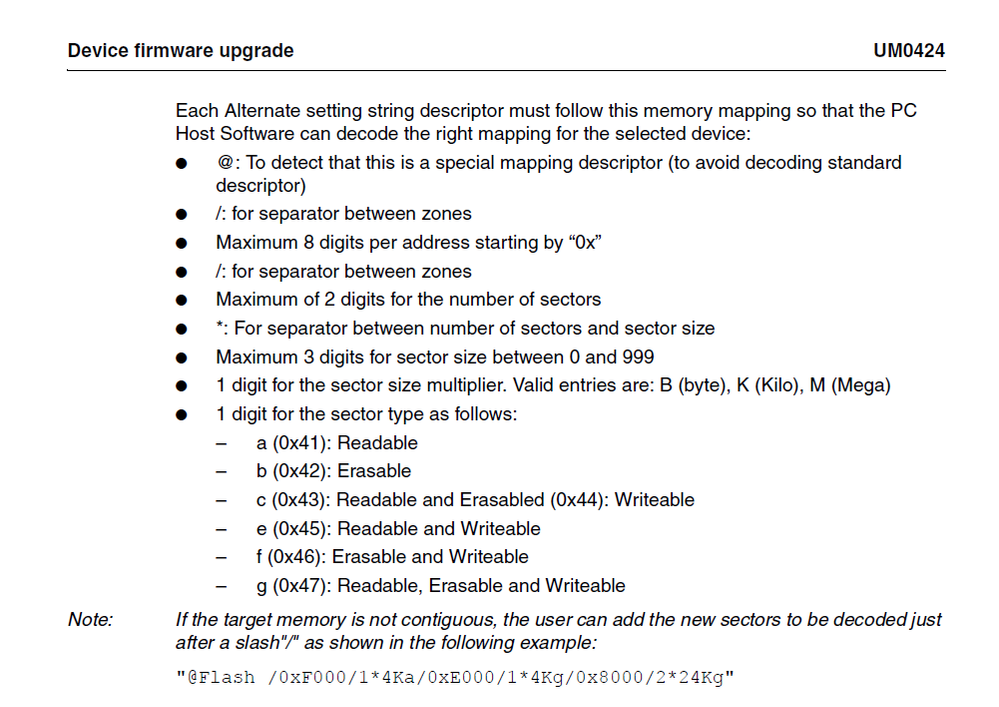

,You need to change and update your string descriptor as explained in the DFU Manual to export a new region , here OTP region or another external Memory. see our Examples in IAP mode provided inbox.

You can use our demonstrations examples as a starting point and then you can customize with different Alternates.
By the way in your string descriptor, do not forget to add the Units : Bytes, Kbytes, Mbytes etc. in this way :
''@Internal Flash /0x08000000/120*128 a,1416*128 g'' MUST be
''@Internal Flash /0x08000000/120*128Ba,1416*128Bg'' B to mean Bytes and a '' Readable here is the definition in
.Page 71/72
