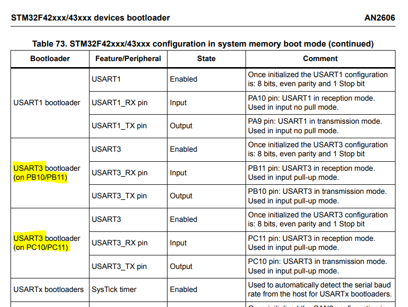

I want to enter the bootloader in system memory using the Nucleo-F429ZI but without success until now.
As I understood, the only thing to do to enter bootloader at reset is driving pin BOOT0 High and BOOT1 Low.
What I have tried is :
Is there something I'm missing ?
Any help much appreciated !
2022-10-14 3:18 AM
Thanks for your quick reply ! It helped me a lot to find the answer.
In case it might help anyone facing the same question, the details are :

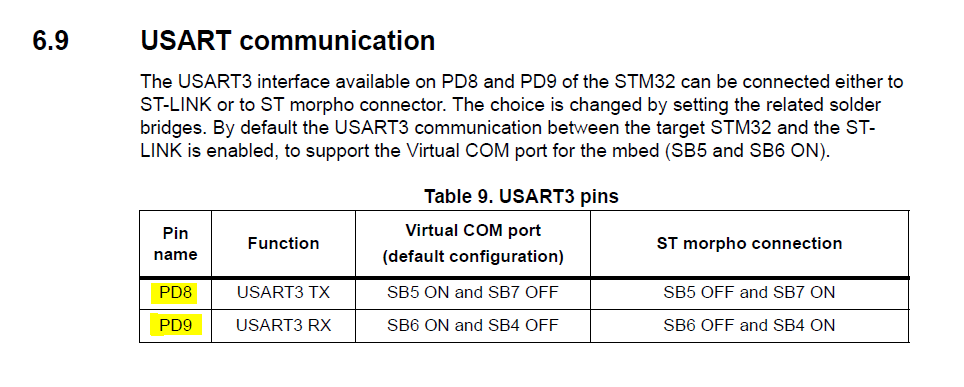

2022-10-13 9:13 AM
You cant use ST Link COM Port
Read AN2606 p172
2022-10-14 3:18 AM
