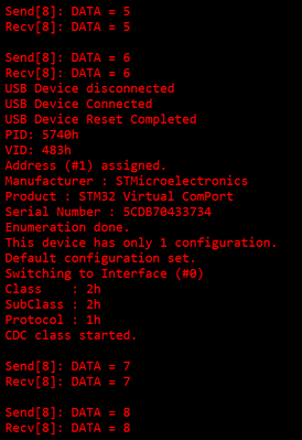

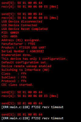

Below are the LOG for the STM32F1 Device(left) and the FT232 Device(right):
I don't know the reason why the FT232 can't support the hot plug function.

(And I already tried the STM32F1 Device CDC example with the same HOST code; all the above problems do not exist.)
2025-10-17 2:21 AM
@Junde wrote:I already tried the STM32F1 Device CDC example with the same HOST code; all the above problems do not exist
As already noted, the FT232 is not a standard CDC device - so that's to be expected.
@Junde wrote:I don't know the reason why the FT232 can't support the hot plug function.
It's not the FT232 - that certainly copes with hot-plugging on other systems - so it must be something missing/wrong in your code...
