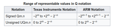

Q1.15 (from Wikipedia)
is in "arm world" -0,999 ... +0,999 , 1 sign + 15 bits fractional.
