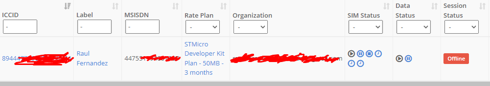

Yesterday I unboxed my B-L462E-CELL1 and tried to get it connected to TRUPHONE. I managed to register the board with TRUPHONE esialy following the instructions.
Then I powered the eval board but it did not connected. Using the flashed firmware, X-CUBE-CELLULAR Version: V5.2.0, ATCModem:NetworkState (EPS) = NOT_REGISTERED_SEARCHING.
Finally, I upgraded the firmware using the binary file in the en.patch_x-cube-cellular_v6-0-1, with the same results : ATCModem:NetworkState (EPS) = REGISTRATION_DENIED and ATCModem:NetworkState (CS) = NOT_REGISTERED_NOT_SEARCHING.
Any help would be appreciate it?
I am in the Glasgow (UK) so the TRUPHONE coverage should be fine.
Kind regards,
Raul
