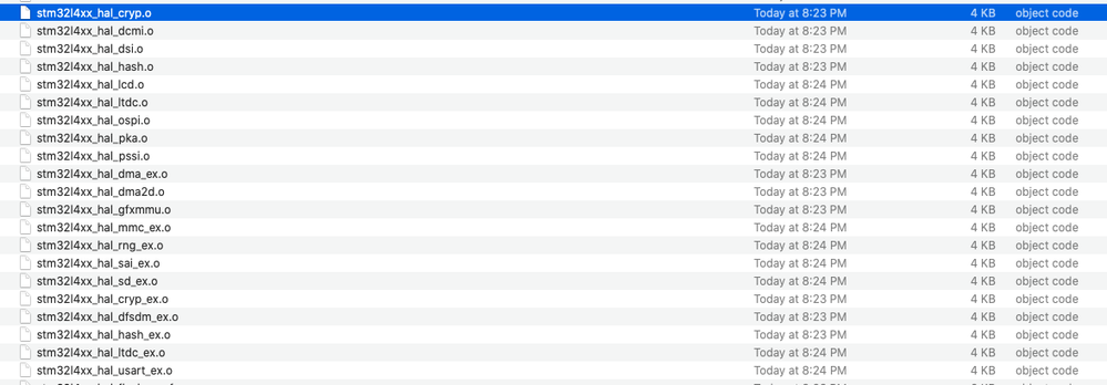

Thank you very much. I was able to get around the problem. However I have a follow up question. The object files generated for few modules does not seem to have any content though their underline implementation does contain code. For example 'stm32l4xx_hal_rng_ex' and 'stm32l4xx_hal_cryp' does not have any content as I observed through GDB. (and the file very small) Do you have any idea about a reason behind this?
This is because all these files are guarded by #ifdef:
#ifdef HAL_????_MODULE_ENABLED
Provide stm32xxx_hal_conf.h with all these symbols defined, for each module you want to include in the library.

I already had defined those modules. For example, I had already defined HAL_CRYP_MODULE_ENABLED is defined in stm32xxx_hal_conf file
2020-06-01 5:29 PM
All these modules are already defined in my HAL_conf.h file
2020-06-01 5:55 PM
So I did for one of MCU from F4 series, and cypt module produce the object file. The only reason I am thinking is maybe these modules, (for example cypto module) is not supported in STM32L4xx MCU that I selected but there in the STM32F4xx MCU. Other than that, maybe there is a bug somewhere in the source codes generated from the CubeMX.
